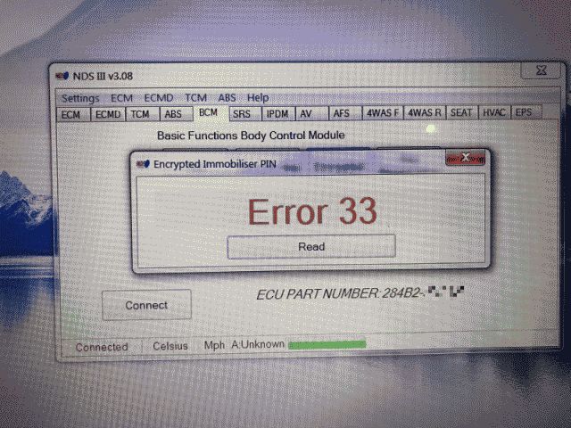

Hello,
I purchased Nissan Data Scan III to program key fob in my 2015 Nissan Pathfinder in USA. I was able to connect to BCM but I am getting error: 33 while reading the immobilizer PIN. I am attaching the screen shot of the error message. I tried to read the immobilizer pin while hazard lights are flashing as well as with hazard lights off, but I received the same error message .
Is there any way to resolve this error?
Thanks.
[attachment=0]NDSIII_error.jpg[/attachment]

Hello,
No answer so far. Hmm.
Has anyone been able to read BCM immobilizer pin from a 2015 or later model Nissan vehicles? :?:
Re: Error message while reading BCM immobilizer PIN
Error 33 means that the request for the encrypted immobilizer PIN was denied by the ECU for a security reason.
