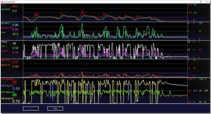

NDSIII version 3.07 has been released. It includes a new Live Graph function. Works the same way as the Data Display function but uses graphs to present values rather than gauges.

Hi Tom
Iam using it. And it is great. Thx Alot
i Still miss the Knock Signal :) can you do something about it
Best Regards Balko
Re: NDSIII update released
There is an update coming that will have improvements to the Address Watch function. You can use that to monitor memory location that holds the knock counter. Unfortunately the address differs between ECU models and requires disassembling the ECU ROM image to figure it out.
