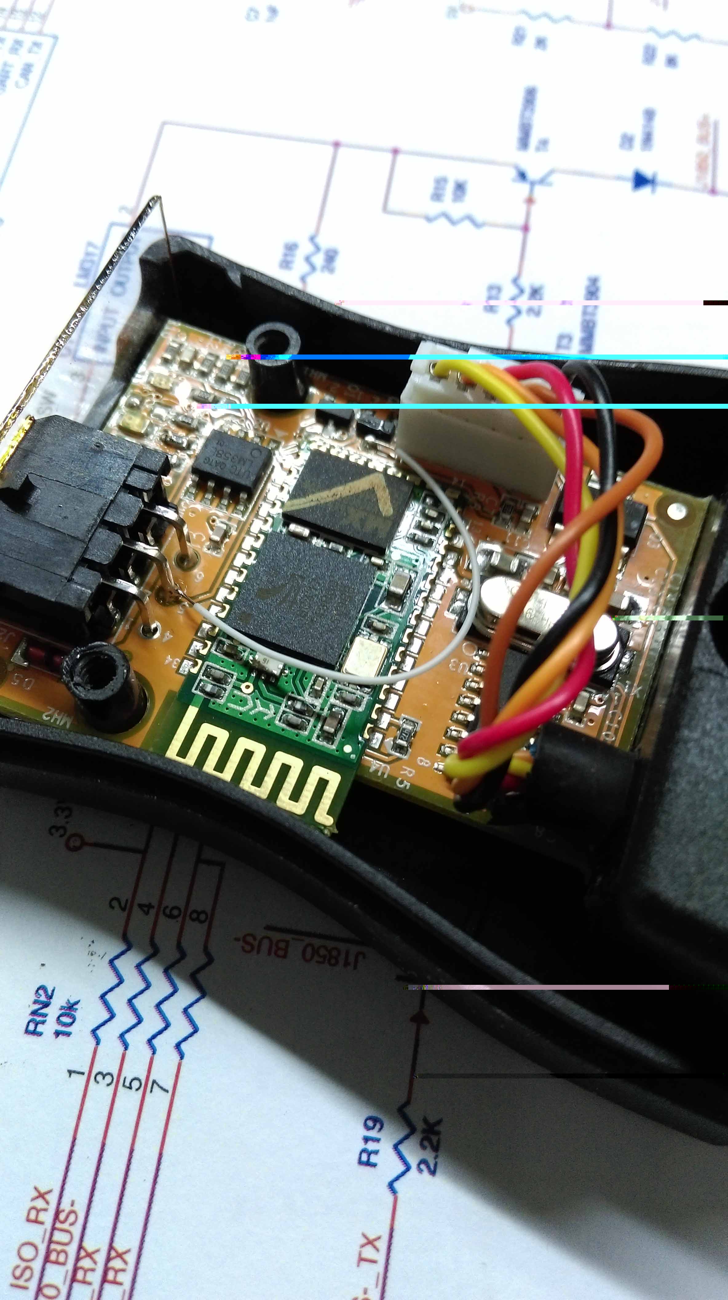

Check if you are getting the clock signal on the adapter CLK pin. It should be reading about 154kHz.
If you are not getting anything return it to the supplier or fix it.
Jason
Posts: 21
Joined: 10 Sep 2015, 17:43
Re: ini failed
Post by Jason »
Fix from the supplier looks like the attached pic. It's the white wire.
A PCB fix will be implemented in the next production run.
Bluetooth Consult I clock signal fix
