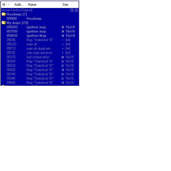

i use version 1.05 on slow mode np 4 i think ill try resume next week, i did dumbopts 0x48 but only reads about 4 address and dropped in np 5 (fast dump) since i stop on 261kp i think i can resume the bin file or should i need to merge two bin files ???? mean while i been try to identify some of the maps !!! i think ill be a great deal if someone check this
