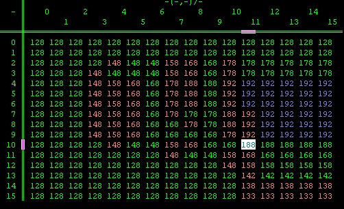

6E11 is the main CAM map. Hard to say whether the calculation for units should be the same as a 40 degree VVT model or not. A log would show the correct way. The uneven spacing is taken care of in the spreadsheet if you look carefully. The first image I posted is skewed since I did not have the axis info then.
6AD1 is probably cold ign timing believe it or not.

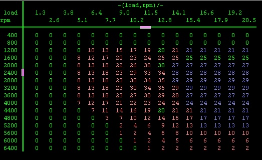

It's interesting what you say about the CAM maps jaf. I finally got hold of stock 350gt ROM and can now compare it to my Japanese tuned one. The CAM map looks a lot different on the 350GT though. The peak seems to be at high load and lowish RPM. I wonder if I should try changing it a bit.
[attachment=1]350GT stock CAM.png[/attachment]
[attachment=0]350GT flashed CAM.png[/attachment]

Hi Tom,
Not sure what conversion formula you are using on your maps? Does your logging agree more or less with the expected advance? I assume you have around 32 degrees absolute max advance so 35 degrees really means max?
For a quick fix on the original ROM, I would shift everything left one column and flatten the max advance out a few degrees. Also add a few more degrees at max rpm. See attached example. That should give you a real good feeling as to what the motor wants.
I'll do up a more comprehensive map over the weekend that will give you a few ideas to try.
The X-Trail is tuned as good as it is ever going to be (which is incredibly impressive) after pinching a couple of ideas from the Sentra ROM regarding ign timing.
I'll publish the final figures shortly and a logging run to go with it.
John

Here is an example of cam timing for the 350GT utilizing the later scheme adopted by Nissan and most others:
1. The "hump" lowers compression and therefore pumping losses. It also introduces a degree of EGR action. If it coincides precisely with cruising loads and rpms, it will enhance fuel economy and engine smoothness without hurting performance. It must fall back quickly to optimum cam timing for power when load is increased otherwise performance will feel uninspiring.
2. Bringing more cam in at lighter loads will increase part throttle aggressiveness. Too much, and the engine will become "raspy" and economy will suffer. Adjust to suit taste.
3. Advance Vs RPM curve is based on typical Nissan Cam timing with next to zero overlap at idle. Too much cam advance acts similar to too little in that volumetric efficiency is reduced. Factory tuning does this on purpose so a lot of timing is pulled back for more performance contrary to expectations of many.
4. If you take out the hump, the map should be close to an optimum performance only orientated map.
5. The factory map is awful.
