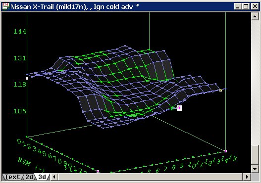

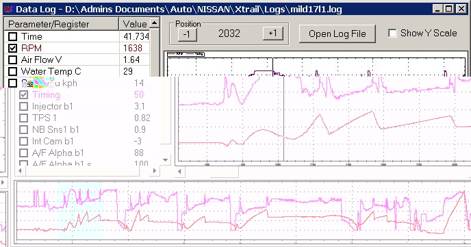

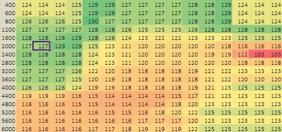

Part 3.... Out in the cold
If you ever thought it impossible that a manufacturer would run 50 degrees advance at 1600rpm then look carefully at the log. This is the
addition of a cold map on top of the low knock map - you can see in the lower graph window how the total advance drops away as the engine warms.
So I needed to pull some cold advance back to account for the extra advance at normal temps - cold driving suddenly got a whole lot better!
This map had me fooled for a long time. I assumed (incorrectly) that it was the fuel compensation map. Finally I put a big hole in this map and
another to prove beyond doubt what each map actually did. Yep, it is the cold advance map!
- cold log.jpg (97.05 KiB) Viewed 52889 times
- cold advance.jpg (70.3 KiB) Viewed 52889 times
- cold advance 3D.jpg (50.63 KiB) Viewed 52889 times
