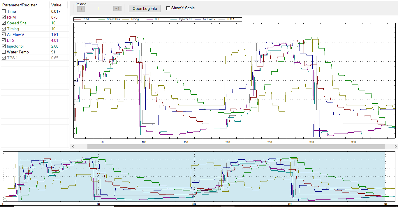

Hey, a log was taken with NDS2 on android and have gone to view it on the laptop however the sampling time seems to be off.
Pics attached. Is there any way to be able to log on a phone device and view and interpret logs on the laptop version (I own both).

The android app uses ELM327 adaptor which has a very limited sampling rate. The maximum you can get is about 3 updates per second. If you are logging 9 parameters, each of them will be updated around every 3 seconds.
