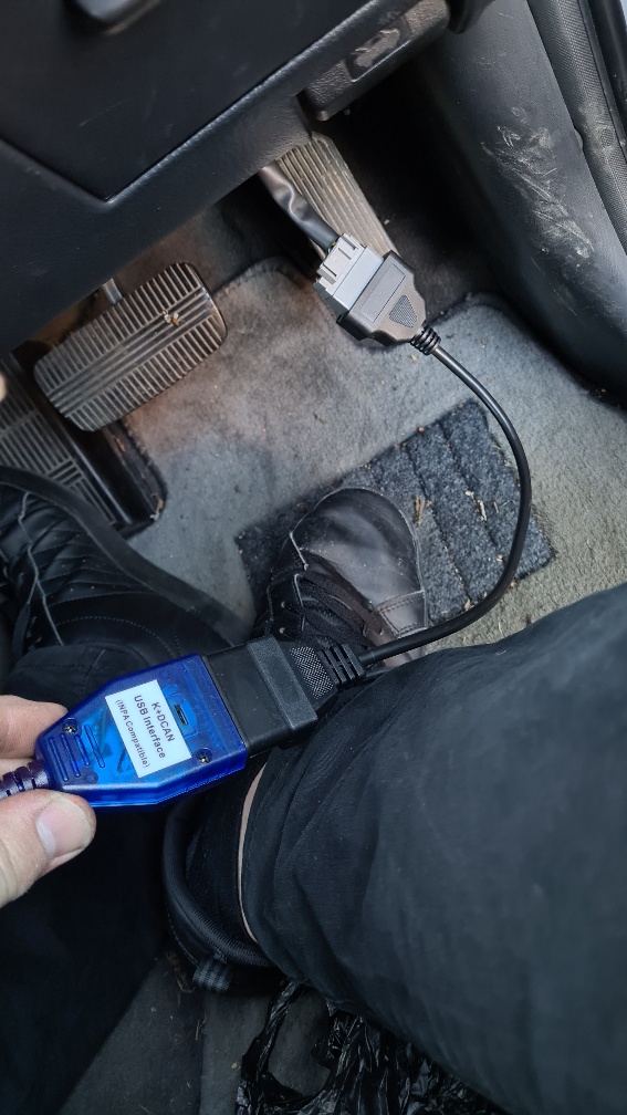

I've tried about 10 leads that I've got lying around from various different softwares.
The only lead that doesn't come up with a com port fault is in the attached picture.
I've been trying to find some info on the white with fix but all of the pictures have disappeared

Re: Nissan Stagea Wc34 Rb25det series 1 compatibility
You are using a VAG cable with 16-pin to 14-pin converter. That's not going to work.
You need a Consult I adaptor with the 14-pin plug. See our website for examples.
https://nisscan.com/NDSI/index.php?content=supportedadaptors
> to work.
> examples.
All site sorted thanks.
