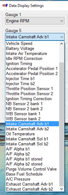

When in the Data Display Settings window and you open the drop down list for one of the gauges, do you have "Intake Camshaft Adv b1" listed?

Negative, all I have is the Intake Camshaft Solenoid.
However, when I go to ECM > Parameter settings, I see "Intake Camshaft Adv" as a listed option.

If it's not listed then it means it's not supported by the ECM.
Parameter Settings function lists all ECM parameters supported by NDSII. Whether they are supported by your ECM or not.
