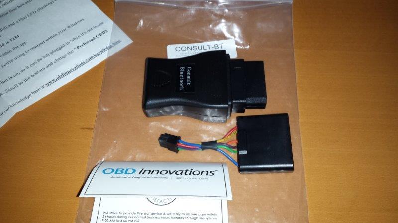

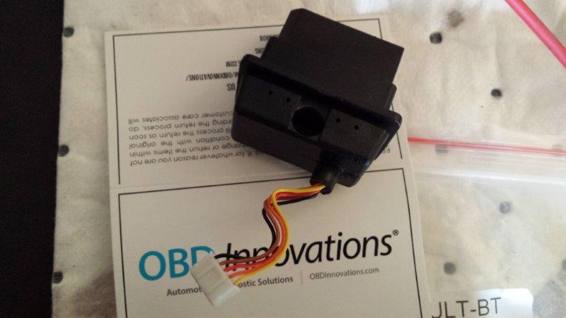

I have a Nissan skyline r33 gtst with a Z32 ECU and nistune. I have bought the OBD1 Nissan consult BT 14 PIN DDL Diagnostic Interface From OBD Innovations as mentioned on the NDS Page. I'm trying to connect the adapter with the OBD 1 & 2 Lite Android app but it's not working.
[attachment=1]20160928_192817.jpg[/attachment]

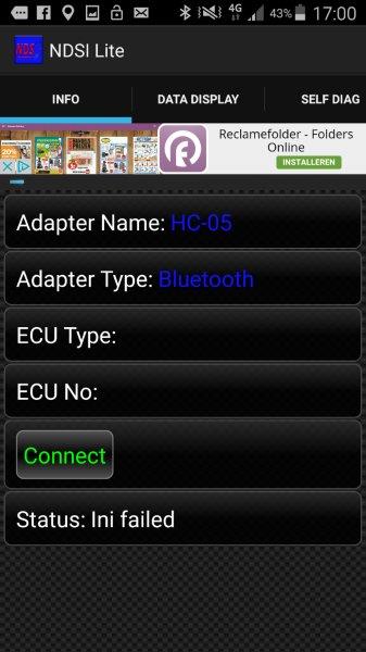

I have tried the NDS1 lite app and after connecting it says ini failed (see screenshot) Also there is no possibility to scroll through the tabs. Screen is frozen.
[attachment=2]Screenshot_2016-09-28-17-00-20.jpg[/attachment]

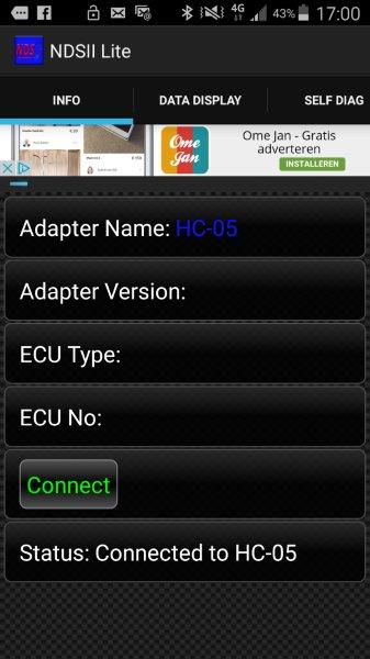

I have tried the NDS2 lite app and there is a connection but the screen is also frozen and there is no possibility to scroll the tabs.
[attachment=0]Screenshot_2016-09-28-17-00-01.jpg[/attachment]

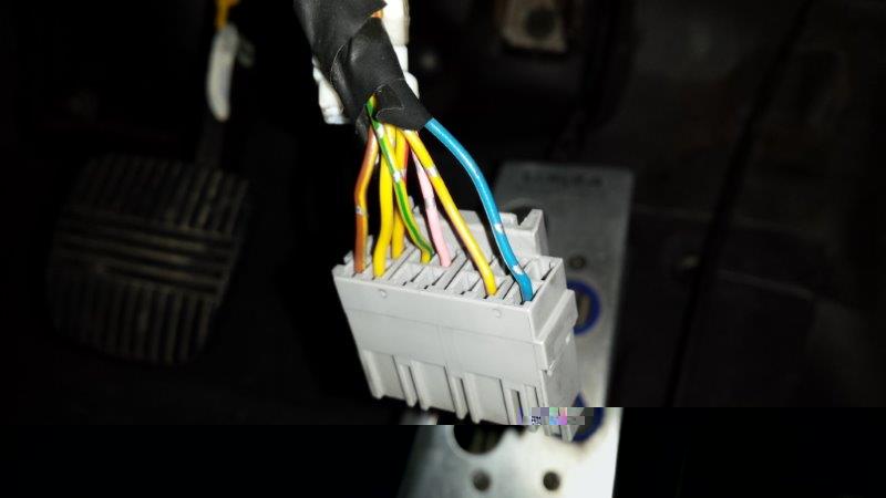

[attachment=0]Connections checked.jpg[/attachment]
I have checked the cables from the ECU to the OBD connector in my car. See Attached picture. These look ok.
[attachment=1]OBD1 connector car.jpg[/attachment]
Pin 1 = (-) black/silver ECU channel 60
Pin 2 = (CLK) yellow/red/silver ECU channel 31
Pin 3 = Yellow/green/silver
Pin 4 = Pink silver
Pin 5 = N/A
Pin 6 = N/A
Pin 7 = N/A
Pin 8 = (RX) Brown/yellow/silver ECU channel 21
Pin 9 = (TX) yellow silver ECU channel 22
Pin 10 = N/A
Pin 11 = N/A
Pin 12 = N/A
Pin 13 = (CHK) yellow/purple/silver ECU channel 47
Pin 14 = (IGN) blue/white/silver ECU channel 45

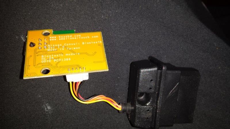

I have cheched the pins on the adapter and the wiring inside the adapter. See Attached picture.
What stands out is that pin 13 and 14 are not connected and pin 7 is not connected @ the ECU. Is this correct or not.
[attachment=2]Adapter-connectorboard.jpg[/attachment]

Re: Nissan skyline r33 gtst z32 (EU) ecu nistune
It sounds like exactly the same problem you are having with the USB adapter and the Windows software. Since you have changed the ECU and you are having problems with both adapters maybe there are issues with your wiring. It could be something simple like the HICAS wiring shorting out the communication lines.
I would suggest bypassing the the car wiring and connecting directly to the pins on the engine ECU.

I have the "Nissan Consult Bluetooth adaptor with optional OBDII interface. Available from www.obdinnovations.com." as mentioned on the NDS site. I've checked the pins on the adapter and cable connector who connects with the circuitboard inside the adapter. As mentioned in my earlier post.
There are 14 pins and 5 wires as you can see in the photo.

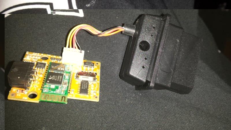

I placed some pictures of the board inside the adapter so that you can see if this is ok.
I also found a topic on the NDS forum about a white wire that needs to be soldered in. This wire is not in my adapter. See link below.
viewtopic.php?f=12&t=340&sid=a181a5a83d ... a5f1c17563
Do the lights come up on the adapter? If they do then the power is getting to the adapter and IGN pin doesn't need to be wired.
The "white wire" fix was only required for the first version adapters. This was fixed by the manufacture in the later versions. You can test this by checking the CLK pin for the clock signal.

Problem is solved. Both the adapter and NDSI app are working.
I got a faulty adapter and had to do the white wire fix.
The problem was that there was no CLK signal on Pin 9 communicating with the ECU.
With the wire fix there is communication with the ECU now.
I want to thank tom for his technical support on this.
